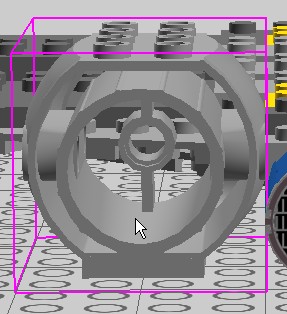

Lalla Posted February 1, 2017 Posted February 1, 2017 Hi all! I'm Miriana, from Italy. I'm new here. I've a trouble with my Millenium Falcon model. When I try to insert a part (photo 1) in the engine (photo 2), part become "ghost" and I can't insert it (photo 3). How can solve this trouble? Quote
KamalMYafi Posted February 1, 2017 Posted February 1, 2017 You need to use Scaffolding technique. Quote
Calabar Posted February 1, 2017 Posted February 1, 2017 Hi Miriana. The "ghost" issue appears when there is a collision problem, due to a partial overlap of a brick with another (usually due to a wrong built or to an error in brick's geometry) or when LDD don't find a connection and try to place the brick in the wrong place. As you problem seems to be the second one, I second KamalMYafi's suggestion: use a scaffolding. A scaffolding is a structure that allows you to place a brick where you want and, once the brick is placed, have to be removed. You can find many exaples of scaffolding in this forum, for example this one: click. Quote
Lalla Posted February 1, 2017 Author Posted February 1, 2017 6 hours ago, Calabar said: Hi Miriana. The "ghost" issue appears when there is a collision problem, due to a partial overlap of a brick with another (usually due to a wrong built or to an error in brick's geometry) or when LDD don't find a connection and try to place the brick in the wrong place. As you problem seems to be the second one, I second KamalMYafi's suggestion: use a scaffolding. A scaffolding is a structure that allows you to place a brick where you want and, once the brick is placed, have to be removed. You can find many exaples of scaffolding in this forum, for example this one: click. I know how, but I can't find something that allow me to scaffolding... :( ... Quote
SylvainLS Posted February 1, 2017 Posted February 1, 2017 A stud or an axle can fit in the center tube. I’d use an axle, then a 2x2 round plate… Quote

Lalla Posted February 4, 2017 Author Posted February 4, 2017 Same trouble, part "ghosts" here... :( Quote
SylvainLS Posted February 4, 2017 Posted February 4, 2017 It’s not very easy to see on your screenshot but what parts are you holding and what parts are already placed? If I remember the instructions, the white telescope is placed first, the corner plate + panels + gold round plate with shaft are put together and then placed on the telescope. That construction doesn’t need scaffolding. You should even be able to place the parts one by one. The white telescope, then the gold round plate with shaft, then the corner plate and the panels. Maybe you forgot the plate under the telescope? Or a brick is a little bit out of place and causes a collision? Quote
Lalla Posted February 4, 2017 Author Posted February 4, 2017 Just now, SylvainLS said: It’s not very easy to see on your screenshot but what parts are you holding and what parts are already placed? If I remember the instructions, the white telescope is placed first, the corner plate + panels + gold round plate with shaft are put together and then placed on the telescope. That construction doesn’t need scaffolding. You should even be able to place the parts one by one. The white telescope, then the gold round plate with shaft, then the corner plate and the panels. Maybe you forgot the plate under the telescope? Or a brick is a little bit out of place and causes a collision? What number has the gold round plate? I not found this...maybe is that trouble. I use a plate 1x1 Quote
SylvainLS Posted February 4, 2017 Posted February 4, 2017 (edited) 20482, in modified plates (plate with clip icon). The shaft/pin on top of the plate inserts into the hole of hollow studs (or clips, hands, etc.). Only available in LDD Extended mode (menu View | New themes | LDD Extended). LDD Extended has more bricks (especially the newest ones) but you need to color your parts (either you choose the color before picking or you use the paint tool). It also allows to paint any brick in any color (even legacy ones, like old grays). (You know what mode you are in with the color of the tool bar: blue for “LDD,” brown for “LDD Extended.”) Edited February 4, 2017 by SylvainLS Quote
