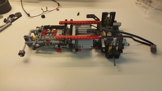

Here is my chassis in progress. Its a combination of Sheepo's rear axel and your gearbox. I think I'm going to have to start from zero again. As I currently have it set up, the chassis still has too much flex which affects how the gearbox works especially in forth gear. Also, I've had to offset the gearbox in order to line up the motors. I'm probably going to have to make the chassis wider so that it "lines up" with your gearbox. Also, will probably use a new rear axel. I'm getting some inspiration from the BMW M4 DTM MOC. What I'm finding is that lining up the input and output of your gearbox is "a pain" but maybe that's because I'm going through the learning curve.
"a pain" :sweet: Let say challenge... :wink: 4 speeders usually have offset in/outputs.
So as much as I see on the pic (it's pretty small, I've used magnifier) you worked out to build the input/output in center, what is a good approach. Me myself building it the same way. Finding out how to build a "stronger" chassis around it is really up to the concept of the MOC in your head, I can't help from the distance. If I find some free time this weekend I'lll build a motorised chassis too with this gearbox, but will use a pair of buggy motors. If I make any progress I'll post some pictures here hopefully those give you some hint or inspiration.
In my experience I need to build something 2-20 times to eliminate the flaws. It takes a master builder to come up with the perfect version for the first attempt. My fingers are crossed for you, don't give up, I appreciate that you gave the chance for this gearbox, I hope wont dissapoint you.
Some technical notes: Did you changed it to 2wd by not using the differencial? Also I wrote in the vid's description that it can take a limited torque. 2PF XL motors are likely to make the driving rings slip out. I'd be gad if you could share your experience later in this subject. :thumbup:
I left the differential in. I plan to power the fake engine that will sit in the front. I'm trying to build my personal sports car into a lego. In this case a Jaguar XKR. But I think the mock will be the XKR-GTS (its got more design elements that I can play with).
When powered up the 2xl motors after stiffening the chassis, I found that 1st-3rd [no load] worked fine. When I shifted into 4th it got a little more challenging. The shifting is also sketchy at times with "grinding" until it gets into gear. The XL motors (if I am not mistaken) are geared up to 36:20 into the input shaft. The output is unchanged. Your gearbox seems to be sturdy enough. Most of the problems I've had are "outside" the gearbox. I need to strengthen a few areas so that the gears don't slip out.

I left the differential in. When I shifted into 4th it got a little more challenging. The shifting is also sketchy at times with "grinding" until it gets into gear.
That is exactly why I did ask you about the diff. If you noticed I was using 3 red clutch gears and 1 old type grey. The one that has direct connection with the differential shouldn't be the red becouse of the collar. The red has collar on both sides, the grey has only on the cluchside. It makes unwanted friction!!!!!
But before you change it consider this:
To power fake engine from the front output is ok. But if you use differential all the torque goes to the way of lower resistance, in our case to the fake engine and your car wont make an inch of a movement but the fake engine revs up. That is what a differential does. So here is the thing: You should exchange the differential to the 2wd version setup (16 and 24 gears+connector between them) and leave the red clutchgears as they are. Please check these things before you get forward.
I was able to make a new rear axle to hook up to the transmission. It was a challenge in the sense that I had a lot of movement between the gearbox/rear axle/chassis. After stiffening a lot of areas, I was able to get it to work well under no load. When I placed it under load, Under load I notice quite a bit of grinding and also that even with 2 XL motors it wouldn't start from a standing start in 4th gear and barely start in 3rd. I removed one of the XL motors to see if it was just too much torque but that wasn't the problem. Then after taking moment to gather my thoughts before throwing the thing against the wall, I had a moment of "brilliance". I remembered that the rear axel that I am using (BMW M4 DTM by Bunojj) has the ability to change the gearing on the rear axle by swapping two gears, and viola! The car now has minimal grinding. Mostly on start, especially in 3rd and 4th. The only issue I have now is that I only have one servo motor which I'm currently using for steering. In what the servo gets here I may be able to change the steering using a regular M motor and use the servo to test the stepper.
I also made a mod to the stepper to keep the rubber band from coming off as it is making a gear change. I added a half pin with bar at the pivots of the stepper (top & bottom). This keeps the rubber band from coming off the arm as it "opens up".
