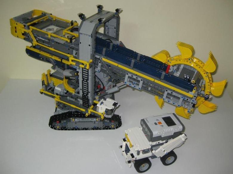

The_Icestorm Posted March 31, 2017 Posted March 31, 2017 I managed to create a MINDSTORMS version of the BWE, a few months ago. The model uses an EV3 brick and PF to control the BWE and an NXT for the mining truck. 2 EV3 medium motors control the drive and super-structure rotation, and 2 EV3 large motors control the boom-arm elevation and lower conveyor belt swivel. A PF large motor controls the main conveyor/bucket wheel, and a PF medium motor controls the lower conveyor. The truck is driven by 2 NXT motor, one for drive and one for steering. More info here: https://www.us.lego.com/en-us/mindstorms/community/robot?projectid=3e125a5b-475c-4a4c-b3ed-e4b4f2192907 Quote
