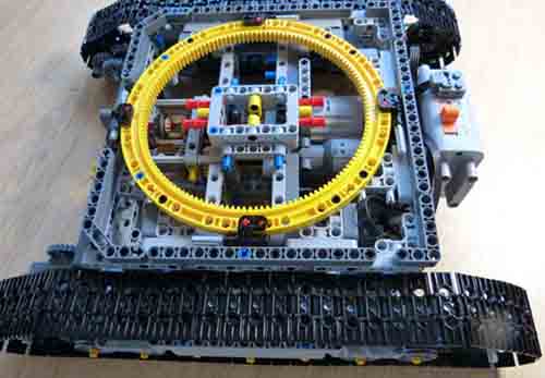

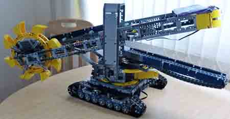

jon hirst Posted November 29, 2016 Posted November 29, 2016 (edited) This is my very first attempt at building in Lego so I hope everyone will forgive my lack of skills and experience 'cos I find it quite difficult to achieve what others have . . .however: This model out of the box does have a few issues and I still believe it is well worth the challenge and making a few modifications to improve things. The addition of additional motors and RC is already beautifully covered, (although 4 or even 5 motors will be required.) The first issue is the lack of steering and slow nodding movement forwards and back. This is due mainly to a long drive chain and the fact that the track footprint is much shorter than it's width. To overcome these issues I've used one XL for the drive and a L motor for the steering and run them through a simple subtractor unit. It works well . . . now if I could only incorporate the battery into the base as well ! I'm currently moving the whole upper assembly a few blocks towards the back in an attempt to further reduce any 'nodding effect and is looking possible . . . The discharge conveyor is easily extended and lowered by a block or two but the main working boom is not only a little short but also bends under the weight of the bucket wheel assembly . . . this is now work in progress so wish me luck. I'm hoping others can improve on my weak attempts ! Edited November 29, 2016 by jon hirst Quote
Imanol BB Posted November 29, 2016 Author Posted November 29, 2016 Hi Jon, welcome to Eurobricks, i must say that i think that you have made a very great work, i had made a modified base which had 2 L motors, each one driving a track, but i am very impressed how you came up with that sub-tractor system, i hadn't even thought of using one, maybe you would need to make some modifications for the upper superstructure to make it fit and rotate properly, but i think it is worth for such great modification, and i think that the extension of the tracks is a great modification too, i knew that they were too short but for some reason i never changed them, and looking at your modifications, i imagine that they must work very well, i am very impressed with your current work, for being your first post in this community, i think you have given a big contribution, and a lot of inspiration for further modifications Quote

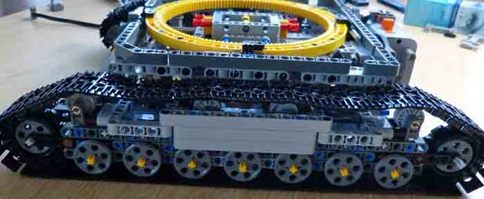

jon hirst Posted December 1, 2016 Posted December 1, 2016 Thank you for the very warm and encouraging welcome. So appreciated! Yes using the subtractor diffs the model now ambles around my lounge as well as any model car and at sensible speeds too. As it stands the upper parts as per the kit fit perfectly with no mods required but I as still trying to improve upon things. I've now added an L motor to allow rotation and hope to add a further L motor as suggested in previous postings to adjust the bucket elevation. The only work the original XL motor now has to do is drive the conveyor belts. Give me a few months 'cos I'm still learning ! Great site ! ! ! ! Quote
jon hirst Posted December 4, 2016 Posted December 4, 2016 Well it all works . . unfortunately not all at the same time as I haven't enough motors and very limited RC gear . . . . It's very heavy, 1 metre long and 375mm high (over 100mm longer and nearly 30mm lower than the kit) It moves and steers really smoothly and the boom is now almost straight and is perfectly balanced (with the aid of 200gram chocolate bar !) The turntable assembly is still wobbly so lots of work needed here, perhaps loads of rollers and stouter fixings. I need to find a way of installing the base unit battery box into the base and still have access to it and I need to pretty things up (more part shopping) Now to strip down and try to improve further and I may try something even more outlandish but more akin to the real thing ! Still learning 4 weeks in . . . perhaps by this time next year eh ! ! ! I'd post a decent photo but I'm only allowed 30kb . . . not sure why. Here's a tiny tiny photo anyway . . . Quote

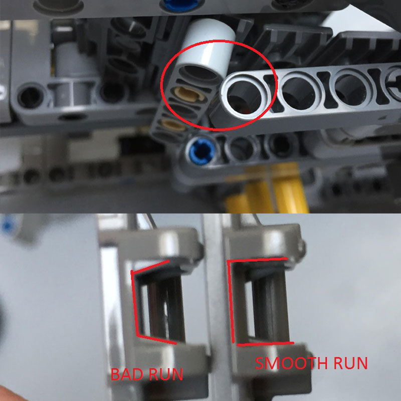

designer-han Posted January 27, 2017 Posted January 27, 2017 (edited) Just being in the process to build the BWE from my spare part collection. I was wondering if some of you run into the next to 'issues' as well. 1) I used initially the DBG treads of the 42042 Crawler Crane, and experienced a very jerky run (including stalling) of the treads over the sprocket wheels. This has all to do with inner tread shapes (bad = triangle based, smooth = square based). I know that TLC changed a couple of years ago the tread design; but I did not expect that the Crawler Crane treads of 1 yr before the BWE should fail. I used the older treads I had, and no issues at all. My questions is: what are the shapes of the official BWE DBG treads?? 2) The conveyer chain of the BWE (upper chain, from buckets to middle section) to jam once in a while. I guess this has to do with the older DBG treads I am using (have more slack). Does anyone experienced this as well? Edited January 27, 2017 by designer-han Quote
