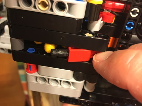

Pangolyn Posted July 4, 2016 Posted July 4, 2016 (edited) I wanted the gears to shift properly (90° with no flipping back a bit) but I wanted a solution I could apply without taking the model apart. I have a ton of axle 2 notched so I put one in each red thing: This works perfectly and can be applied without too much trouble. The inner one is a little harder to insert but it's doable with a creative use of another long axle and an axle connector. Continuing to build to verify it will work with the body added. Edited July 4, 2016 by Pangolyn Quote
