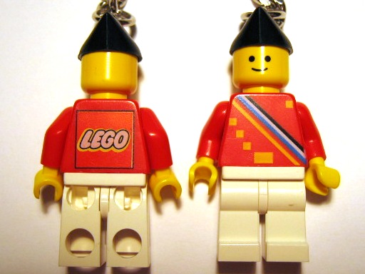

SirNadroj Posted November 3, 2007 Posted November 3, 2007 Hey! ;-) I searched EB for a thread like this, but I didn't find one. So on to my question: Is there a way to remove the keychain from LEGO keychains, so I can end up with just the minifigure (with a hole in the top ;-) ) Are there any specific tools or techniques? Because I want to get rid of the keychain portion of my ambassador keychain, but I don't want to break it, because it's the only one I own, and they're not cheap enough for me to buy a bunch and experiment with on bricklink. X-D (Ambassador keychain, in case you don't know.) Thanks for the help! :-) Quote

SlyOwl Posted November 3, 2007 Posted November 3, 2007 If you want the actual minifig with detachable parts and all: 1. Remove hands, arms and legs. 2. Using a craft knife, incise around the bottom of the torso, deep enough to cut through the glue but not to damage the legs. I would advise having the knife slightly onto the legs as they're less valuable than the torso. This may damage the "studs" on top of the hips, but they're easy to replace. You could just pull and pull but this can damage the pins. 3. Pull away the hips. 4. Grip the chain bit in pliers and bend the nearest loop to the minifig's head back and forth until it snaps. There should now be no blockage in the way of the metal thing sliding out. 5. Using a tool/bent wire/scissors/pliers/cut up bit of metal/etc of some form in the shape of a V (I like to use flattened needle nose pliers or my custom screwdriver, specially filed to the perfect shape for minifig heads), insert it under the head. Use it like a lever and the head should pop off. 6. I've not found a way yet of filling in the hole in the top of the torso or the headgear or seperating the head from the hair/hat/helmet, but I don't think this matters. This method worked like a dream on my Majisto keyring. :-P Quote
SirNadroj Posted November 3, 2007 Author Posted November 3, 2007 EUREKA! IT WORKED! ;-) Thanks for the help so mcuh guys! I did use Captain Sly Owl's technique, since it was easier and worked better ~ but I couldn't the the metal screw out ~ I had to break it. Oh well! X-D Work area: Me as an ambassador (you may see a new sig fig from me soon! ;-) ): Taken apart: The coolest hat ever: Beret: Bottom: Torso w/ broken screw I'm gonna buy 2 more and take another apart and keep the other intact! :-P Quote

SlyOwl Posted November 4, 2007 Posted November 4, 2007 EUREKA! IT WORKED! ;-) Glad to help. I did notice from the photos that you had the same trouble I often have with the leg "studs" breaking off. :-D Can't solve that one! I've added a more refined tutorial onto BS, here. Quote
