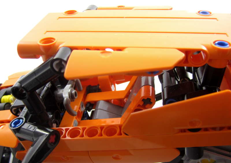

Of course it won't permanently twist axles, he's an AFOL, but put this construction in any of the sets he linked with the F1 suspension arms and Lego will be looking forward to alot of angry emails.
And again, I can't stress this enough: another solution that is more Lego and kid friendly is very easy to do.
And the model looks cool, I agree, but I can't vote for a model with such an obvious illegal technique that is so easy to fix.
Give me a set that twists an axle and I'll back off.
Appie, what do you think happens when you use an axle to transfer power? It has torsion stress applied to it, and the resistance to the torsion is what transfers the power. The only thing that changes is by how much an axle twists - hand operated models are more likely to have less torque being applied to an axle than axles hooked up to PF motors. Almost every official Technic set has a function that transfers torque through an axle.
There is nothing illegal about using axles to transfer torque, it is what axles are made for. What Lego avoids is applying too much torque to axles, which is perfectly normal. The axles are also designed to accept a certain amount of torsion without deforming or snapping. Lego expects them to twist a bit.

Which I think this model does. Not in your hands, but in the hands of a kid? Yup, or do you seriously think they are only going to be pushing that "suspension" only while the model is on the ground so that it will touch the ground before it twists the axle too far? People come in this topic and claim it should be an official set, while it fails the first criteria for an official set.... (and thus failing one of the guidelines for this contest: "make it as official as possible")
But Appie, my whole story about normal use of axles in Technic sets! Yup, but they never have to endure the abuse that a kid can put on this suspension and if an axle in normal use in an official set does have too much torque applied to it the design team goes back to the drawing board.
Seeing as neither of us have done a finite element analysis to find the breaking point of this model, your argument is completely moot. Even of we did have this information, you are speculating as to what TLG considers as acceptable limits.
Since you are basing your whole argument on information that is unavailable to either of us, this discussion should stop here. You made your points, I made mine, let's keep the contest fun.
Considering Lego has never used this type of suspension in 40 years I think we are well beyond the point of speculating. In fact it's more likely that one of the reason they made the F1 suspension arms and used them in all the models you linked was to provide an alternative to this type of suspension with less risk of breaking parts. The only thing stopping a kid from turning your suspension about 60 degrees is that flimsy cockpit made of connectors and soft axles. But whatever man. Just tried to help make your model more kid friendly and thus more Lego-like. You don't want the advice? Fine. Good luck in the contest.

Tonight I decided to test the front suspension to its limits by applying as much force to it as possible (you can see my fingers shaking from strain in the video).
So far, I had only tested it on a table, with the travel being limited by the chassis.
I told myself that if the suspension busted apart, if parts broke, popped out or separated, if the axles got twisted and the suspension wasn't returning to its original position, it would need a redesign. If it held, it would stay, as it passed Appie's Kid Test.
Here are the results:

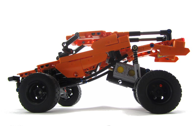

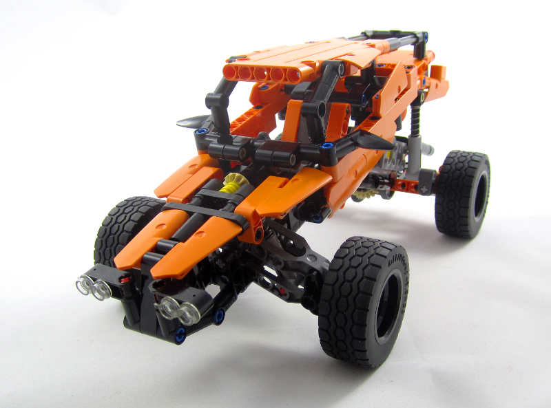

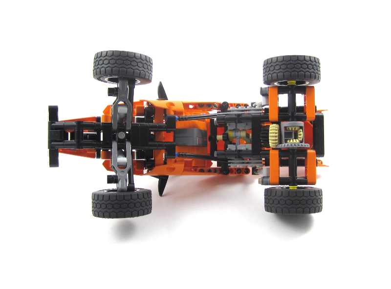

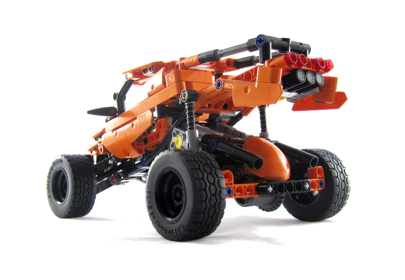

The B model is a trophy truck called Sun Stinger. Key features:
- Independent front suspension
- Dragged axle rear suspension
- Fake engine with differential
- Ackerman steering
Here are some pictures:
I'll make a video later this week.
