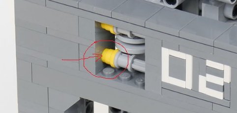

Hello, can someone tell me what this thing is. Does anyone have a part number for it.
Edited by waslos
@waslos I have some of them and they offer no difference to a normal bush in this case. As far as I can tell, Akiyuki just likes using them because they are rare and unusual. I like how he used them with the Ball Factory for aesthetics, but I wouldn't advise going out of your way to get them.
Actually it provides a spacing which is bigger than a half-bush and a bit smaller than a regular bush.
Akiyuki always use this part to materialize an offset between 0.5L and 1L.

Quickly hacked this together, so apologise for it looking a bit meh.
So yes, it is a different height to a bush, but to be honest, not by much. Less than a milometer.
Have I ever seen Akiyuki use in a manner where the size difference made any odds? No. It certainly doesn't with the Ball Factory and it doesn't with the Invisible Lift. If it does with that robot, it would be a first for me seeing it. Looking at it though, I doubt it. It is way more about aesthetics than anything else.
So as I said before, if you have them, go for it, use them. If you don't, I wouldn't go out of your way to get them, as it makes no odds. And this is from someone who goes out of his way to use black 3L pin, black 2L axles, black bushes and black axle pins. I use them for aesthetics and that is why I use the hubs, no actual practical reason.
It can be more than a millimeter if you put the thinnest part against the hole of a Technic brick, as he does in the above picture. See the example below:
I've done this quick and dirty:
When you zoom in in MLCad, on the right the wheels touch the cylinder.
On the left, there is a small amount of play. It may makes a significant difference in the end.
