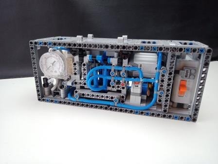

It was a nice challenge to reverse engineer this design. That’s what it’s was about for me. At this moment I don’t have the intention to run it for hours. As I will have only one GBC module, I’m not planning to attend any exhibitions.
The ball cleaner has 7 48mm medium cylinders of which one is only used for the pressure switch and 2 32mm small cylinders. Not all cylinders are operated at the same time and there’s an airtank built within the module. Nevertheless using an external air compressor feels like cheating to me. I will build the XL version with unreinforced cylinders and see how that goes. If necessary I’m upgrading to XXL. :wink:
@Lego_GBC_NL There is 2 cylinders in the build behind the gauge (see picture below...I need to get a Fliker account...). The cylinders help with spikes of usage however the compressor has to re-fill the gas that has been consumed and continue to supply the module/build. The ball cleaner will need at least one cylinder to provide volume for high use moments of operation due to supply line restrictions. With any pneumatic build it is good practice to include one as close to the valves as possible (within the module you have built).
@Juroen The 48mm cylinders will consume a lot of air. I do agree with the cheating thing... for me it is I either build 4 compressors to get it to work well or I put that funding into other builds. I also do not believe that the compressor cylinders do well when running for long periods of time.
The key with my compressor is that there is a central drive shaft that drives the compressor cylinders from both sides there by lessening the torsion effect on the drive assembly. Let me know when your building yours and I will send you the LLD

Ok great, that's good to hear! At the moment I have 2 blue ones, but will acquire more airtanks if needed for any huge pneumatic project :grin: Still consider giving Quanix' Pneumatic Ball Factory (v1) a go at some point in the future, seeing that reverse engineering has been done for a considerable part of it and decent instructions have been created (KrisBrix, Turbopolofr,...).
I agree with both of you on the cheating thing. I'm really a Lego purist as well, so would be great if no external devices are used!
