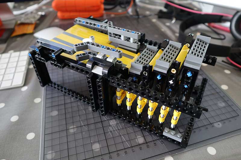

Here's a pic of my take on a lift mechanism for the Invisible lift. It's a version of the one Akiyuki uses for the Cycloidal Lift, but adapted to take 3 balls, rather than just one. I've also reworked the hopper.

on the left side the part that connects to the black ball joint pin should be the same piece as the right side, for some reason the rebricker did this change.
