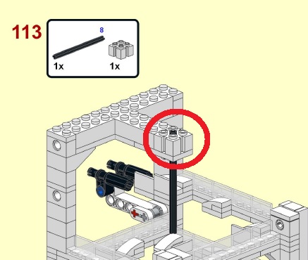

DrJB Posted March 27, 2017 Posted March 27, 2017 (edited) I was going through some of the instructions (commendable work, Blakbird et. al.) and I found a tiny/minor error in the cup-to-cup module. The five gears to the right are placed 1M higher than they should be, and as such, they do not mesh with the center gear. This might have been addressed before but, just in case. Cheers. Edited March 27, 2017 by DrJB Quote
DrJB Posted March 27, 2017 Posted March 27, 2017 Also, what's with this part? It used to be rather cheap but now, because of Akiyuki's modules (invisible lift & planets), it's about $0.30 each? Supply and demand again? Quote
Blakbird Posted March 27, 2017 Author Posted March 27, 2017 5 hours ago, DrJB said: I was going through some of the instructions (commendable work, Blakbird et. al.) and I found a tiny/minor error in the cup-to-cup module. The five gears to the right are placed 1M higher than they should be, and as such, they do not mesh with the center gear. This might have been addressed before but, just in case. Cheers. I think you are referring to djm's original draft instructions. The final instructions I published all have the gears meshing perfectly. There are other differences in design between the two versions as well. Edit: You may have downloaded an early version of my instructions. My original idea to use train windows didn't work and I updated the instructions, at the same time fixing those gears. Make sure you get the latest version. 5 hours ago, DrJB said: Also, what's with this part? It used to be rather cheap but now, because of Akiyuki's modules (invisible lift & planets), it's about $0.30 each? Supply and demand again? This has happened with a few parts, including DBG bricks in general. Quote

DrJB Posted March 27, 2017 Posted March 27, 2017 (edited) On 3/27/2017 at 0:05 PM, Blakbird said: I think you are referring to djm's original draft instructions. The final instructions I published all have the gears meshing perfectly. There are other differences in design between the two versions as well. You're absolutely right. The instructions did get updated and look fine. Though I think the front cover (POV render) still shows gears with an incorrect offset. Not many people would notice those as well. Also, I somehow have an LDR file and it has the incorrect offset in it as well. one would notice that of course. There is an Akiyuki Rainbow Wave module? ... I thought such module was done by someone else, but he was 'inspired' by Akiyuki. Can you put the link to the module you're referring to? Edited April 3, 2017 by DrJB Quote

Gopman Posted April 1, 2017 Posted April 1, 2017 @Blakbird is step 49 in the PDF instructions for catch and release an inadvertent duplicate of step 48? Quote
Blakbird Posted April 1, 2017 Author Posted April 1, 2017 2 hours ago, Gopman said: @Blakbird is step 49 in the PDF instructions for catch and release an inadvertent duplicate of step 48? No. Step 48 installs the top supports, step 49 installs the bottom supports. Quote

Gopman Posted April 2, 2017 Posted April 2, 2017 22 hours ago, Blakbird said: No. Step 48 installs the top supports, step 49 installs the bottom supports. Well, that certainly improved its operation - it's not spitting balls everywhere. Thanks! Perhaps you can add an arrow to the lower hole where the supports go. I had to go back to my PC and flip back and forth to find it. Quote
