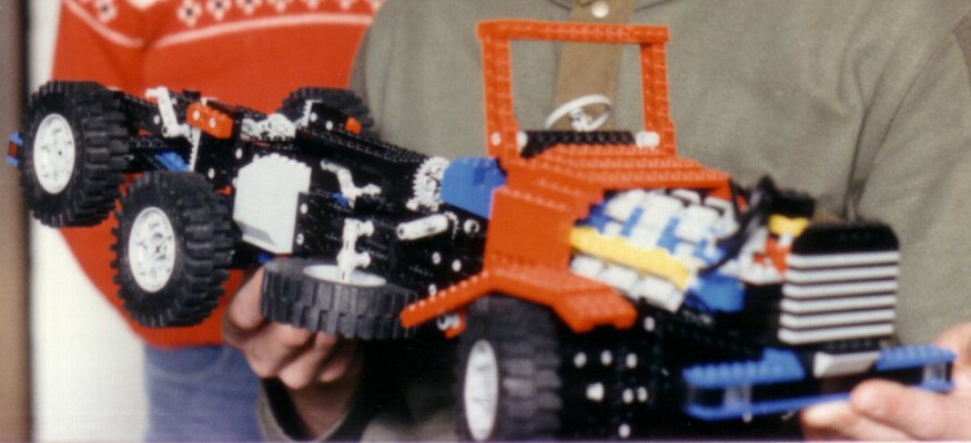

When I was 16 years old, I reverse engineered the large truck model that can be found on pages 38 to 41 of LEGO Technic Idea book 8889. It had to be built with elements from sets 8860, 8859 and 8848, but I managed to build it even without set 8859...
