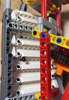

1 hour ago, tismabrick said:
Interesting findings. How do you actually know that the motor housing is 2 bricks and 1 plate high? From the image you provided I would not be able to tell how high it is.
In that last image, you can see the two 1 x 4 Bricks. Then above those two, there is a single plate. e.g. you can see the line between the bricks.
I also use the vertical Technic liftarm as a guide. e.g. where the bricks line up with the holes. This isn't perfect, as you are not looking at the module directly on, but it can help.
