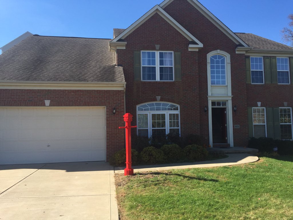

sixf00t4 Posted October 27, 2015 Posted October 27, 2015 I built a lampost for my house and I want to know how best to protect it. Does anyone recommend a UV protector clear coat? How about a glue for the ~6 foot tall lampost? It's pretty much all red 2x4 bricks. I'm thinking about clear silicon sealant on the interior to try to protect it from the elements a bit. I do plan to wire it up with a working light. Quote

Hinckley Posted November 6, 2015 Posted November 6, 2015 what would be the application technique? just coat it after it's built? put drops on each brick as it is layed? MEK should be applied between the studs on the "dirty" side of the build, meaning the inside. Anything that leaks over the edge towards the outside, which is viewable, will melt the brick in the shape of the drip and look terrible. UV coating will cover small mistakes but you don't want to damage the outside of the brick. So, apply the MEK between the studs (hopefully you are using 2x brick). Then the UV coating is applied to the outside of the model once the glue has dried, which shouldn't take too long, considering it is spirit based and evaporates quickly. Make sure you glue in a well vented area and let the model dry in a well vented area. The fumes will get trapped inside the model and pour out into your brain when you move it, otherwise. Perhaps buy a ventilator mask, a dust mask will not help you. Did Dr. Spock work for LEGOLAND and design models for the parks? NO. I did. Acetone is not a glue. I found this, a discussion on acetone for gluing ABS, but I personally think it's nuts. At the parks we used GBL or MEK. The guys who were out in the field all the time preferred MEK. The product you linked to is a solvent, designed to clean. If you want to use acetone, feel free but make sure it is the lower percentage in the mix. If you have more acetone than glue, it is a solvent. Hell, give it a shot. I think, as interested as Merlin is in saving money, if acetone was an effective glue, they'd be using it. Most sources I found, by searching on google for five minutes, say that acetone alone is not enough to melt the elements together, nor does it create a tight seal. Why don't you purchase some products and start finding out for yourself? Do some research and let us know how it goes. Quote

sixf00t4 Posted February 1 Author Posted February 1 Oh wow! Blast from the past! 10 years later and i’m both embarrassed at how naive I was but also so grateful for how wonderfully patient and helpful everyone was here! lamppost is doing well! I’ll try to snap some pictures when i am home later today. I power wash it every 2-3 years and then reapply the UV sealant via spray can. I’ll see if i can find a pic or link of the product i use. It does give it a layer of “texture”, so id entertain better options, but it works well enough and is easier to apply than a brush. for assembly, we used cans of MEK/acetone and just like was expressed above. 1-2 drops on the “back side” is totally sufficient. Bonded within 30 seconds. lamppost was the trial run for the 200,000 piece we were commissioned to do for the University of Pittsburgh. having trouble uploading pics small enough from my phone…will reply once at home later tonight. Quote
