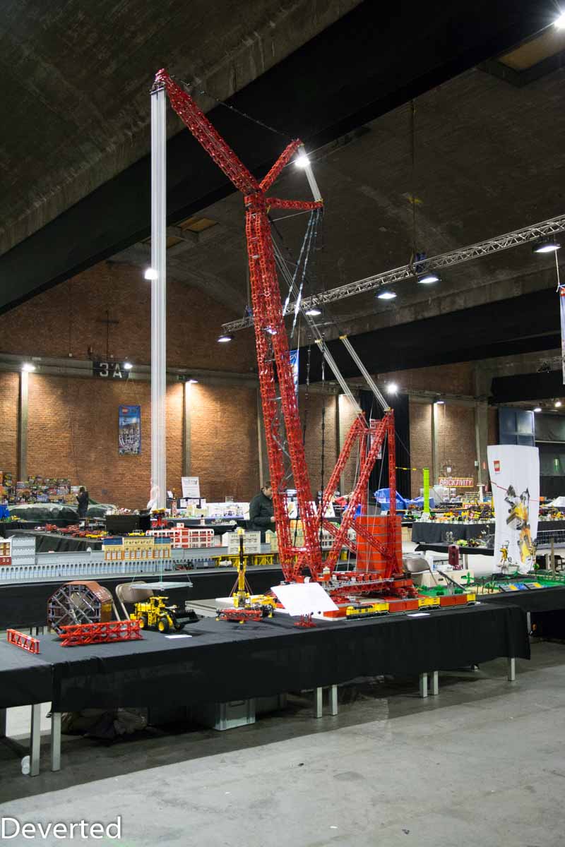

that i didn't see this post earlier, actually I have build a ptc-200 from mammoet.
it is build to minifig scale and had to include some modifications as lego and bending don't mix well

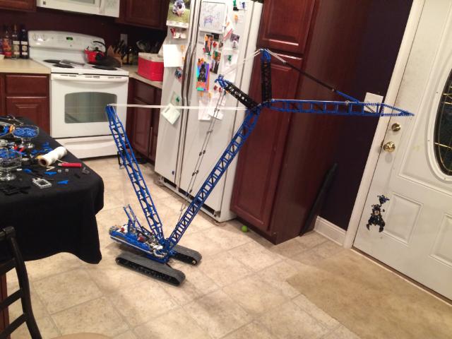

Progress report:
Main boom extended by two sections, jib built, and jib masts started. The join between the main boom, and jib was probably the hardest bit.
The two grey Technic beams are temporary until I build a winch for them. My first set came with one spare of the long grey support things with a barrel join at each, so I was expecting the second set too as well......turns out it didn't so I'm one short at the moment. Did anyone else set come with an extra one of these?
Still to do:
Rebuild the main boom's mast
Build a counter weight, and hopefully build a third winch into it somewhere.
Build the pulley system between the jib boom.
Look at extending/widening the tracks slightly
If anyone has any ideas/suggestions would love to hear them. Also are there any cheap sets that contain one of those grey long tension supports with the barrel joins at each end? (I have two yellow ones)

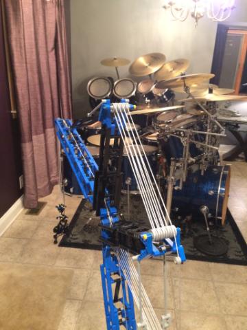

42042 was my first lego crawler crane. Ive always liked the look of big cranes so i decided to try my hand at it. Here's my first version on the 42042 model.
I lengthened and doubled the tracks, widened the space between the tracks, essentially doubled the superstructure, added a second pf battery box for counter weight, doubled the main boom added at second, and added 2 jibs at the top.
