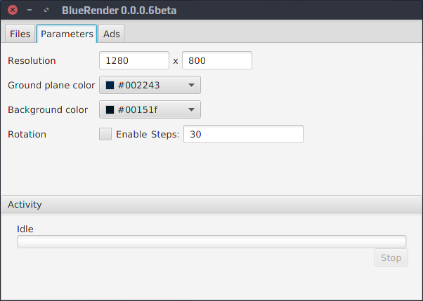

inkpanther Posted February 21, 2018 Posted February 21, 2018 (edited) On 2/21/2018 at 7:46 PM, blackdeathgr said: Hello guys! I am new in blue render and I would like some help. Is there a way to make shading a bit darker (either via blue render or in LDD) because the way white bricks appear to me, they are too bleached thus losing some of their detailing when using textured bricks. Also can I make the resulted picture a bit bigger? Expand You can set resolution of a render in a tab called "Parameters". As for whites been being too white, or blacks too black for that matter... I think there isn't much you can do about it. You can play with light settings, but some things will always be seriously overexposed or underexposed. Edited February 21, 2018 by inkpanther Quote
