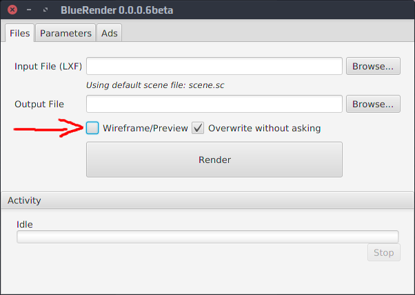

22 minutes ago, fastbjorn said:
Hi, I just downloaded Bleurender.
But I have a problem, I only get black and white image's.
See picture below:
<image>
Can one of you help me to get a collored picture.
You probably have selected Wireframe/preview option.
