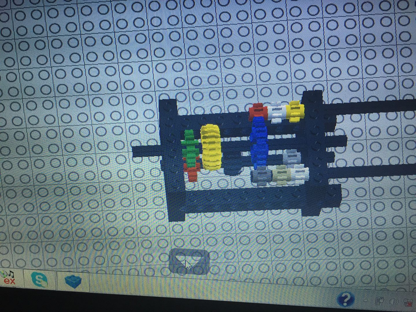

Grosse Kind Posted February 19, 2015 Author Posted February 19, 2015 (edited) Pics would be wonderful thankyou. I fed this into LDD: and they all physically fit, just concerned by the width of the 20 as seemingly thicker than the limit of one studs movement per gear either not engaging from first to second fully or still holding in the shift from second to third locking both shafts solid. Again, much appreciated. Edited February 19, 2015 by Grosse Kind Quote
thomol Posted February 19, 2015 Posted February 19, 2015 (edited) Here you go! As you can see I have an equal distance between each gear on the upper shaft, your solution with the 16t and 20t beside next to each other works as well, I tested it this morning, but didn't take any more photos. There may be a risk of the gears slightly engaging simultaneously, if you're not careful when aligning them. That shouldn't be a problem though; you wouldn't change gears when the car is moving when using an unsynchronized gear box like this one anyway... Edited February 19, 2015 by thomol Quote

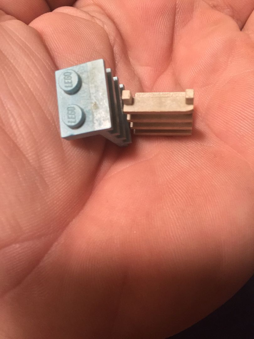

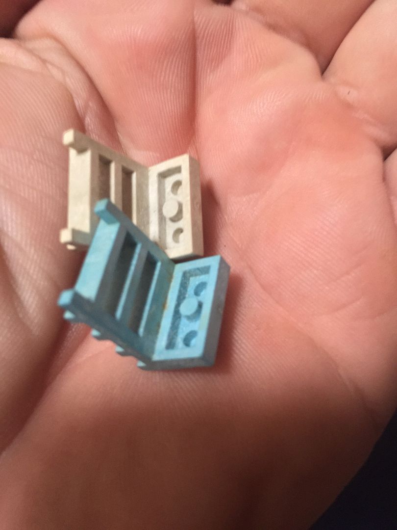

Grosse Kind Posted April 7, 2015 Author Posted April 7, 2015 (edited) Well, took the plunge and dropped in the 12 and 20 the other day. Comfy with how it all works and put the diff pinion back to the standard 14 tooth. Life is to be a lot easier on the uni's in the swing axles at a minimum, and the gearshift still feels ok. [/url The standard ratio gears and a spare diff pinion up under the front chassis. A habit of mine to keep any supplanted parts on the vehicle itself to allow easy return to standard. My gear detent system, to prevent it jumping out of cog when rolled backward: Slight peeling from a 4 long axle lets it slip into the detent pin traps. Edited April 7, 2015 by Grosse Kind Quote
miguev Posted April 7, 2015 Posted April 7, 2015 And the axle is... corroded? Like of few of mine from the 80s, what's up with these axles? Quote

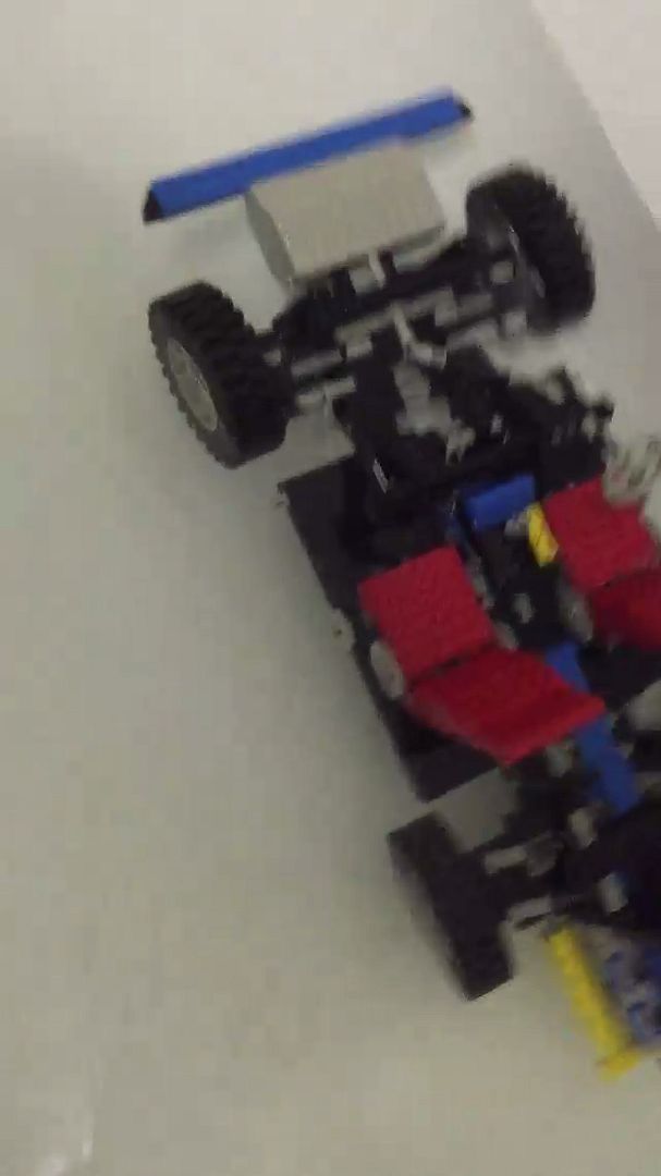

Grosse Kind Posted April 8, 2015 Author Posted April 8, 2015 (edited) I've an air compressor and could blow her down skaah, but realistically she's never seen the inside of a cabinet and is played with too frequently (still, a rolling testbed and in one piece since i got her in 2009) to fret about trivialities as a little/lot of dust. But seem as i'm nothing if not accomodating i'll check her for bouyancy later this eve (i've an odd feeling she's not gonna float real good), in the bathtub, and if she sinks i'll push it back and forth a few times whilst attempting to make underwater "vroom vroom!" noises, and see if it gets any less dirty. Not confident but at least it'll be the first flat four propelled submarine. May need to revise the engine fan blade pitch but. ;) Hi Miguev. It started life as a 12 long axle with an inclusion in its moulding that cracked into two pieces around the 4.5/7.5 region. I filed a standard-like chamfer on the cracked end and have since rough pared down the splining in the middle with a pocket knife to experiment what profile taper and width would slide easily through the friction pins allotted as shift gates but not slip out the opposite way quite so easily. When the ratio of first was still six to one, she displayed a propensity to pop out of gear into a false neutral of sorts, and even in the higher two gears, if you rolled it backward the gear lever would flail the other way and often popped out of gear. What i have since used holds each ratio captive using a broken part i modified slightly rather than dispensing with. I'd never seen corroded lego before till i found some of my 80's stuff also the other month. In places its almost chalky and there's blistering on it but i've never come across axles like yours. I have one that is so twisted that if you follow the spline one end to the other, it has a full 1/4 turn to it plus the aforementioned cracked axle, but generally they've always seemed pretty stable. Might i enquire, in your burial grounds of sacrifices to the lego gods there, i think i can see full width bushes, with toothed ends. Are these common and/or reasonably recent as they're totally new to me. Thanks for your time, glen. Edited April 8, 2015 by Grosse Kind Quote
Saberwing40k Posted April 8, 2015 Posted April 8, 2015 Those pieces are not actually bushes with teeth, but part of an old angle connector, and have snapped off in such a way that it looks like a bush. I also am fond of modding broken parts although not for this purpose. Quote
Grosse Kind Posted April 8, 2015 Author Posted April 8, 2015 (edited) Thankyou sabre. As a bit of a surprise (click video link below): she does actually float! Currently drying off. Edited April 8, 2015 by Grosse Kind Quote
