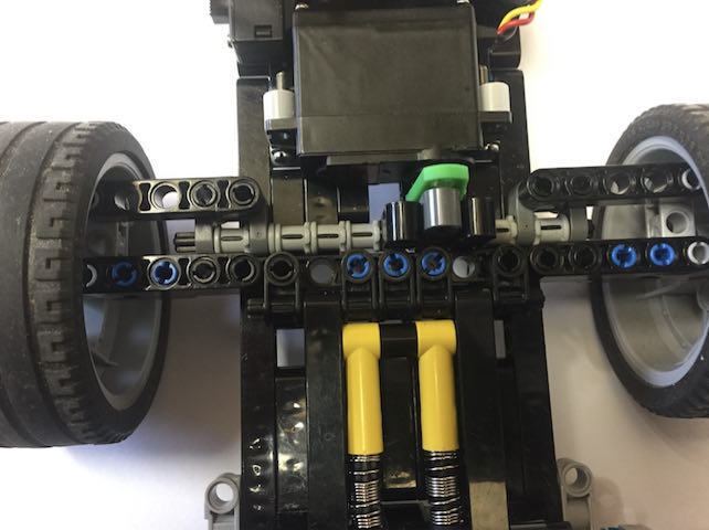

Hi there, just ran into your Le Mans Car on Youtube. Great stuff!!  (Also) Posted a question regarding the ball bearing. If you can share any details, much appreciated (can't find it on Shapeways ....)
Noticed the car steers slightly nervous. Had the same problem. Resolved it using attached mechanism. Just for inspiration. Please notice the modified bush (1/4), gives a tiny bit of toe-in, works well.
