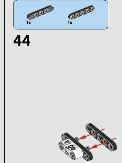

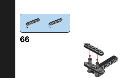

You forgot the new bucket on 42061
Wagh, I was hoping to forget that I gave up on making a mockup image of it, too. Something involving splicing these together:
The angle of both images should have made it simple, but I got too tired to judge exactly where to splice the beam from the claw onto the bucket and gave up.
