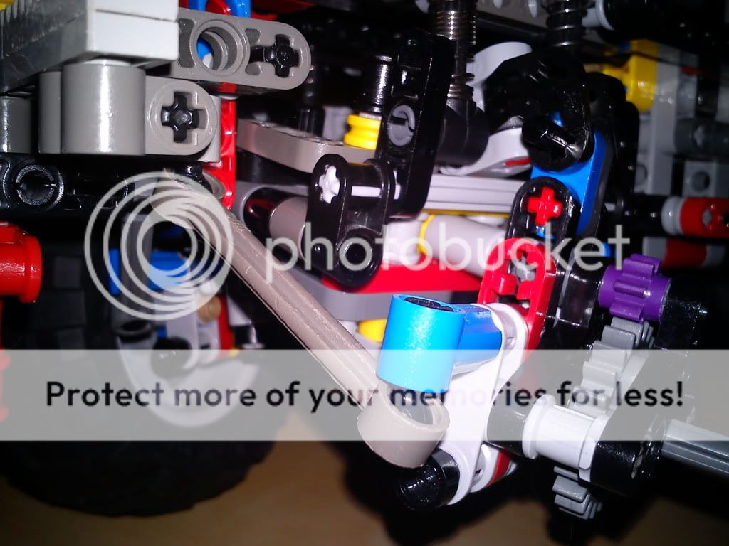

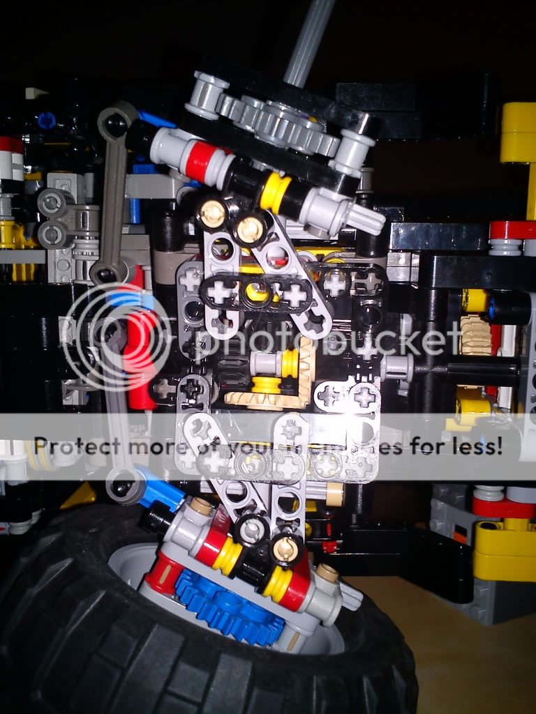

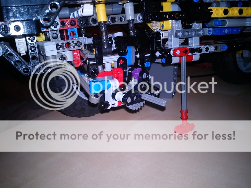

T_Tank Posted June 19, 2012 Posted June 19, 2012 Interestingly enough I tried out the LPE kingpin inclination axle setups at the portals on a old tatra i have sitting around >.> it actually gives it some cleaner steering i think an wasn't half the nightmare you would think to impliment. An also to get the turning axis closer in i used triangles over the unimog portals (this took me about 3hrs to figure out) An yes my tatra is a modified nico71 tatra with a sariel 2speed gear box (still need to figure the shift motor) an now home to some LPE kingpin inclination inspired front steering systems -currently have it with some toe in to keep the tatra from pushing its suspension down in forward gear T815 with LPE kingpin geo1 T815 with LPE kingpin geo2 T815 with LPE kingpin geo3 an as you can see from above the cab looking straight down it is turning alot closer inside T815 with Kingpin Geo cab down view T815 with kingpin geo cab down view alt Quote
nicjasno Posted June 19, 2012 Posted June 19, 2012 (edited) Awd and fwd vehicles in general should have some toe in, because the driving force pushes the wheels a bit outward and gets you a neutral toe when in motion. Very well done btw. Edited June 19, 2012 by nicjasno Quote
