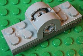

He wrote, "I started building this when I needed remote control for our display in Blackrock. Then I remembered the Reverse Engineering Challenge in RailBricks 9 so I used that as a starting point. Looking for inspiration I found this idea by Chris Alano which looked promising. I didn't like the little lever to hold down the Technic steering connector. I then remembered the mechanism in 8052 Container truck and realised I could replace 32068 with 42003 [shown below] for a much stronger solution.
It all worked well and it's smaller than the design in RailBricks..."

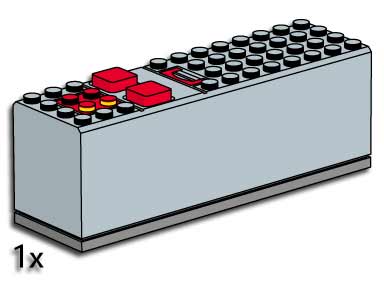

I used the PF to 9V cable, then a long 9V cable and then the old pole switcher:
Posted Image
A friend of mine used the same cables but with the old battery box:
Posted Image
The advantage of using the battery box is that the motor can't stay on accidentally.
