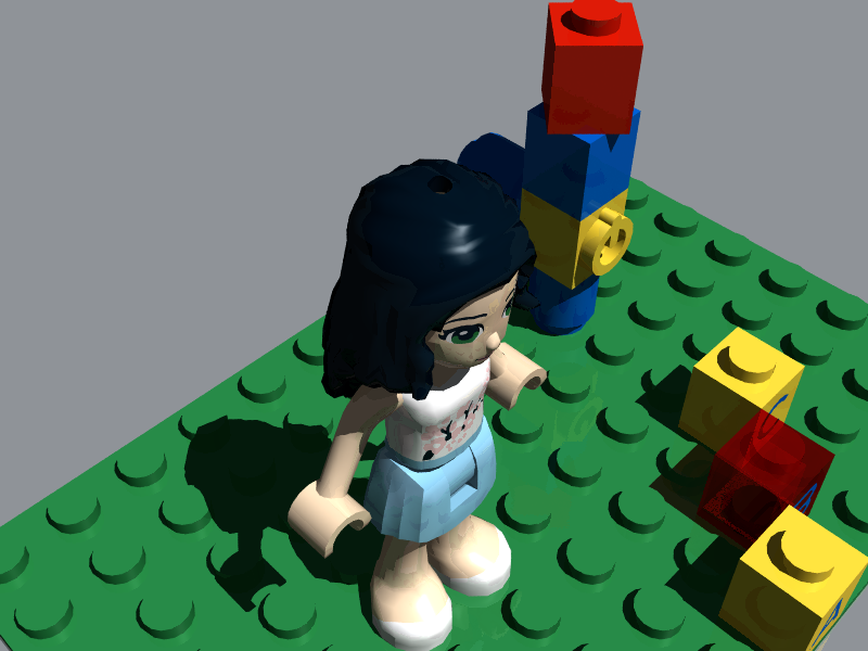

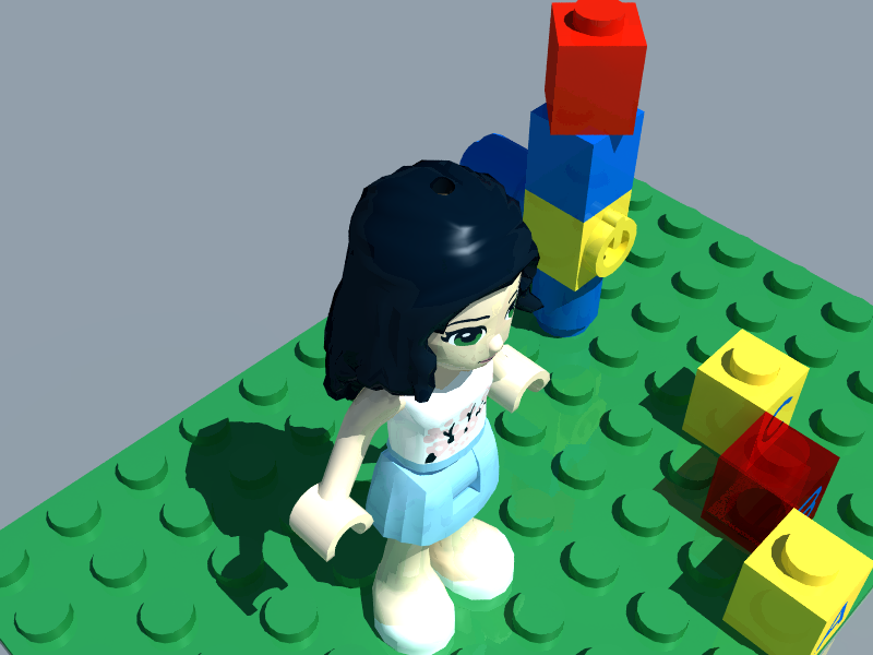

roland Posted August 20, 2016 Author Posted August 20, 2016 Thanks to both for your thoughts. Hi, my first advice is purely selfish: export the model as a separate file from the scene and settings, say “model.inc” for the model and “model.pov” for the scene. For now, I’m using LDView (which works fine with LGEO) and a script to get rid of the scene’s particulars in order to use mine (ground, lights, settings…). I was thinking about allowing include files to override stuff but have a contained single .pov by default. So what’s the reason that you are not satisfied with your render? Which feature is less optimal? May you please provide a render? The main thing I'm 'fighting' currently is to have a single default setup which looks good/roughly the same color wise when used with or without radiosity enabled. Currently this gives me (without radiosity): and (with radiosity) Which seems over exposed (I think I'm using emission wrong, but I read somewhere to use that instead of ambient). I also don't really understand the sky sphere, as yesterday it blended the whole scene and now it suddenly only changes the background color and seem to influence the global lighting while I'm pretty sure nothing has changed This is generated from my current test export: http://www.melkert.net/test/povTest.zip The zip includes the original ldraw file and the LDCad animation script, but will only work with my last dev build, but might give some insight in how animations are generated (feedback on that is also welcome). Quote

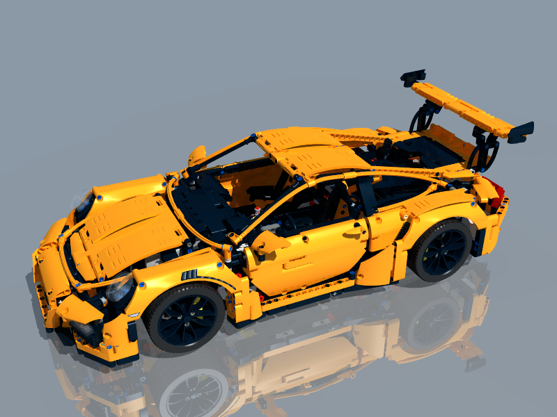

roland Posted August 20, 2016 Author Posted August 20, 2016 (edited) Just got the blended background again, same settings just a bigger model (with radiosity same settings as the above zip file): Edited August 20, 2016 by roland Quote
papacharly Posted August 21, 2016 Posted August 21, 2016 Roland, from my understanding (1) ambient is a simple, but effective and good method to add lighting to black shadowed areas. You may state this method is kind of a fake. (2) radiosity is an high Q and advanced ray tracing method to calculate the influence of scattered light from all parts to all other parts, respectively to shadowed areas too. So this method simulates reality. Obviously this is a time consuming procedure. (3) emission is not meant to replace ambient light or radiosity. If you add emission to parts, these parts will emit light, they act as a light source!! As bricks usually do not glow, I think its better to not use emission. The same is true for your plane (floor). BTW: A good method to only see e.g. the influence of the plane (or any other part) is to switch off all other lights (light sources, sky sphere, glowing bricks,…). Feasible standard values (without radiosity) usually are ambient 0.3 and diffuse 0.7. If you use radiosity instead you may set ambient to 0 and diffuse to 1. This is your setup (test_pc.pov, incl_pc.pov) without emission and radiosity, but with ambient 0.3 and diffuse 0.7: Not sure I understood your requirement “single default setup …” in the right way: If you use the same settings for rendering, rendering either with or without radiosity definitely has to lead to different results. If you would not see any difference after rendering it would make no sense to add radiosity. Sky sphere: I do not use sky sphere as a light source. It generates some kind of homogeneous respectively unnatural lighting from all directions. I prefer setting up specific light sources. It may make sense if you wish to create some patterned sky, respectively if you explicitly intend to show parts of a patterned sky in your renders. So what’s the reason for using sky sphere? What are you aiming for? BTW: An excellent povray tutorial with lots of examples can be found here. Quote
roland Posted August 21, 2016 Author Posted August 21, 2016 Thanks for the info and alternative .pov's from my understanding (1) ambient is a simple, but effective and good method to add lighting to black shadowed areas. You may state this method is kind of a fake. (2) radiosity is an high Q and advanced ray tracing method to calculate the influence of scattered light from all parts to all other parts, respectively to shadowed areas too. So this method simulates reality. Obviously this is a time consuming procedure. (3) emission is not meant to replace ambient light or radiosity. If you add emission to parts, these parts will emit light, they act as a light source!! As bricks usually do not glow, I think its better to not use emission. The same is true for your plane (floor). I'm not sure about ambiant/emission thing, from the povray helpfile: Note: Versions of POV-Ray prior to 3.7 did not provide the emission keyword for finish, and it was customary to resort to ambient instead for such purpose. This is now discouraged, as ambient is now disabled when using radiosity. This is why I switched to emission, it works quite well until you add a sky sphere. Not sure I understood your requirement “single default setup …” in the right way:If you use the same settings for rendering, rendering either with or without radiosity definitely has to lead to different results. If you would not see any difference after rendering it would make no sense to add radiosity.. I meant a single file using control variables, so #if can be used to make decisions I was hoping to the user a single 'out of the box' setup which will look decent when using ether option. That way you could e.g. use radiosity for single frames and disable it for animation (that is if you're unwilling to let it render for hours when doing a animation of a couple of minutes :) ) Sky sphere: I do not use sky sphere as a light source. It generates some kind of homogeneous respectively unnatural lighting from all directions. I prefer setting up specific light sources. It may make sense if you wish to create some patterned sky, respectively if you explicitly intend to show parts of a patterned sky in your renders. So what’s the reason for using sky sphere? What are you aiming for? I didn't like the hard separation between floor and the horizon you see when the camera angle is low. Thanks again for the feed back papacharly. Quote
papacharly Posted August 21, 2016 Posted August 21, 2016 This is why I switched to emission, it works quite well until you add a sky sphere. Hard to realize that my povray knowledge is kind of old-fashioned, as I still stick to ambient instead of emission. Seems I have to learn again and reconsider my technique (some day) ... I didn't like the hard separation between floor and the horizon you see when the camera angle is low. Possible solutions for avoiding this hard separation are given in this topic. And kudos to you for doing all the work with respect to LDcad!! Great tool. Quote
