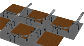

Here's my design for a modular elevated track system for running down modular city streets. It goes around road corners, spans over ground track (enough clearance for the xmas train), and lines up between normally ballasted tracks. My feed has pics and video of it in use for our club displays. https://flic.kr/s/aHskkWx5Np
