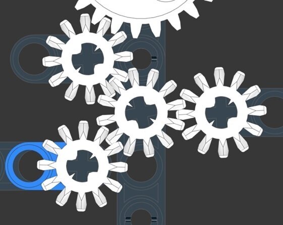

  2. Hi gyenesvi, Thanks for the feedback — I really appreciate it. I take the practical RC constraints seriously and value the shared experience. Just to add some context: this build is about exploring engineering limits in a controlled way, not just RC efficiency. I enjoy adding complexity and pushing boundaries; functionality is why I chose Technic. Part of the motivation is simply to explore and learn by pushing systems slightly beyond the obvious use case — even if some ideas ultimately get discarded. The original 8× idea has already been tempered. At this point, I even question whether it outperforms the 4× range. Regarding the idler: I am sceptical about it and will dump it if it doesn’t serve any real purpose besides acting as a neutral gear. Regarding the 12T–12T diagonal: I fully agree it doesn’t work in a simple L-beam setup (top-left), but that’s not what I’m using here. I included a view of the theoretical backlash according to Studio; in the lower-left view you can see how far the cam actually pushes the idler. The cam’s hold position itself still has some tolerance and limited adjustment. That said, the difference compared to the standard LEGO layout on the right is small, but this extra friction could amplify at higher speeds — to be tested. The scale will likely be around 1:9 to match my 8.1cm wheels, but I haven’t committed to the bodywork yet — first priority is getting all modules and software to work. Thanks again for your input — it helps keep the experiments grounded while still leaving room to explore.
  3. Hey 2GodBDGlory Thanks for the thoughtful feedback — these are exactly the points I’m trying to validate. An 8× speed increase is indeed aggressive. In practice, shifting into 4th would only happen near maximum speed in 3rd. The cam-activated idler disengages the drivetrain during shifting. The drive motors are briefly unloaded and the wheels decoupled, so no back-driven forces return into the gearbox and there’s no risk of two clutch elements engaging simultaneously under load. The idler is only engaged when a gear is fully selected. I agree this adds complexity, and it’s one of the first subsystems I’d remove if the drawbacks outweigh the benefits in testing. The timing, positioning, system response (rubber band actuation), and supporting software all need proper evaluation. You’re absolutely right about the 12T–12T mesh: while it works geometrically, friction and wear are real concerns, especially for RC use. This is one of the areas where physical testing will be decisive. On the input side, the two drive motors are currently coupled via a 20/12 ratio, but this can also be changed to 16/16 or 12/20 without major redesign. I’m keeping this flexible for post-build tuning once real-world losses are clearer. Finally, directly coupling the shifting motor is a fair suggestion. I opted for mechanical indexing and locking to ensure defined gear positions under vibration and load — especially since the idler mechanism itself benefits from precise indexing — but this choice is also open to revision if it proves unnecessary. Thanks again for the critical look — it highlights exactly the weak spots I want to test next.
