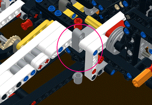

  3. Got the wings on today... another bit of fussy assembling. But I do think I had a couple minor realizations around how Lipko did the center section that might better inform my build order. I do have a question for Nerdz or Lipko though... When I installed my wings, they are very floppy and I'm concerned I may be missing something. Is there supposed to be some sort of connection between the LtGrey T-shaped technic and the white wing panel? (see attached) To orient, that orange bit on the right is the propeller drive 'nipple' and the you're looking from the port/aft above toward the center section.
