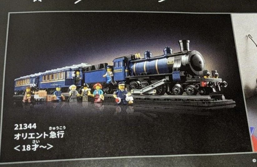

  14. My guess based off of this new photo is that they're doing what most of us do and choosing to omit an axle piece going in and out of the cylinder to really bring the union link right up to the cylinder. You'd probably need 3 studs of play for the rod. I can't wait to get this side by side with the Emerald Night, some people are saying the cylinders are too high but that looks on the money for 10194's clearances so the pilot bogie can handle R40. Also, didn't catch that plow they've got below the buffer beam!
  15. It’s been pointed out that this is the Japanese on the image, I would have no clue for verifying that. loco looks brilliant, I think Lego’s choice to round brick the smokebox face beyond the cylinders is a solid move on their part, and the buffer situation is a good way of going at it. The only nitpick is that I’ll be ordering a 2H9L rod so I don’t have a random hole in the main rod, but other than that this looks fantastic.
