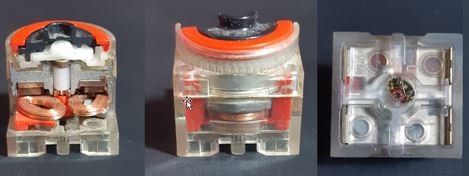

you can easy to see if you have "the crumbled magnet" problem on transparent motors. Turn the motor in the direction of strong light and look over its side. the magnet is the upper side above the rotor (under the rotor there is a simple iron in plastic holder) You should see a little gap between the magnet and rotor and same gap between the rotor and the Iron. It is clearly seeing in my cutted motor picture. But if the motor is whistles is means the rotor is turning so it is not magnet problem.

"Is there a non-destructive way to open these motors?" Yes, there is. BUT You need a "simple tool" to open the motor house. and one other to open the Gearbox. For the motor opening: You can see 4 hole in the top of the motor. if you push in 4 pins at same time to here, motor will open. For the Gearbox opening: You need a special pinchers with the profil of drive wheel. If you pull the drive whell up with this pincher the locking ring will pop up and you can take out the planetary gear and the planetary cog wheel and the parrel. I am absulutely sure that the raison of wrong motors is the magnet. and if you could open the motor , very complicate would be clean the magnet. but even if it succeeds you sholud snaps together the motor again. and for this you need a special tool too. If you see the bottom of the motor you see two little kidney shaped hole. here should push in two very thin needles, and "move" the brushs to the rotor's collector that they do not demage while you pushing the gerbox and the motorhous together again. It is not easy. and the magnet which started to crumbling will not stop the pulverization. And change the magnet is not possible. No we did not make dark gray micromotors. (I do not why. We have lot of grey ABS because we produced the all plastic parts for Mini Motor (injection molding) :-) ) I hope you understand my wrong english :-)

I and my "old" college have some pcs from these motors, if he have not sold or thrown out them. (I do not know this because i did not meet or talk with him in the last 20 years :-( ) Yesterday I went to my garage and I made inventory about my rare parts. I took more photose but i can not upload here because only 100 Kb upload allowed me here. (????? in 2020 ?????) I have 4-4 pcs yellow and purple and 5-5 pcs blue and green and 9 pcs transparent motors. Yesterday I tested them again (last time lot of years ago all of them was good) BUT NOW only 1/3 of them working :-( :-( I dismantled one transparent motor and i saw the typical problem which we had with micromotors and Mini-motors too. The magnet was crumbled. and the magnet dust clogged the little gap between rotor and magnet :-( We used powder metallurgy magnets what we order from China. Lot of magnet started to crumble after some months the magnetizing. Unfortunately It was known problem.
