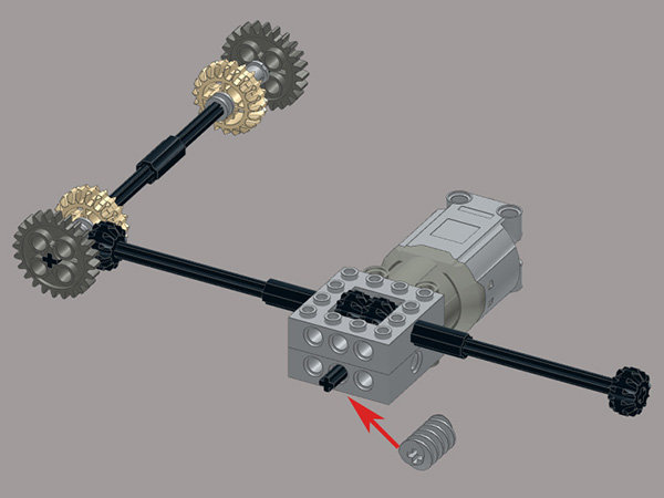

  1. I don’t have any detailed pictures of the mechanism. I checked your post about the 10212 Mod and I can give you some tips. It’s a bad idea to attach the L-Motor the way you showed in your last post. Place the motor in the center of your model. Take a look at book 1, page 23 of the 10212 instructions. The gearboxes and the 1x11 Liftarms are important parts of the mechanism. The gearboxes create the needed torque to keep your wings in place and you need the 1x11 Liftarms to attach the wings. In your case I would remove all four gearboxes and the two 32324 Technic Bricks and replace it with the following custom gearbox. Maybe you need one more gearbox and motor on the opposite side too.
