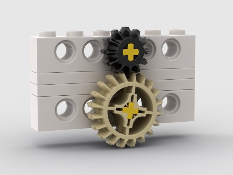

It seems this is a design bug by LEGO. Maybe LEGO should have asked a mechanical engineer before designing new gears. The design of tooth profiles was compulsory in our basic studies: https://en.wikipedia.org/wiki/Involute_gear The old gray gears from my Technic Sets from 1990 have involute gears. Very smooth and almost frictionless...
In the Crocodile 10277 is a gear combination like the screenshot below. A black "12 Tooth Double Bevel" (32270) and a tan "20 Tooth Double Bevel" (32269) between two technic bricks separated by two plates. My problem: it seems that gear combination don't work smooth. It it keeps stalling, it rattles and it runs very stiffly (high friction). I have tried the same gears from other sets, but the problem remains (sometimes worse, sometimes less bad). What is going on? Are these gears ar not made to use it in this combination? Or is the design of the teeths wrong for this wheels? https://en.wikipedia.org/wiki/Gear#Nomenclature
