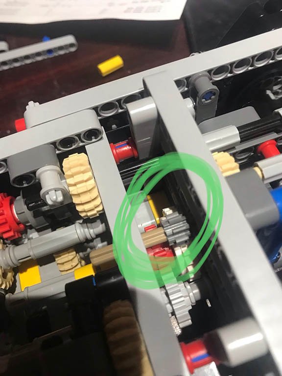

    2

  1. sigh.......lol, maybe if i hadn't actually failed to do step 12, i would of had more success.....but thanks, i looked at that over and over and failed to notice what i missed..... now, for the fun part of trying to figure out the path of least resistance to fix it:) thanks again to you both....
