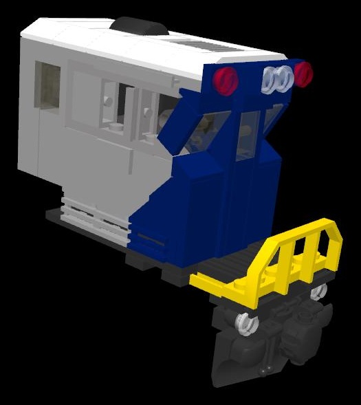

Thanks for the advice. The handrail will now be fixed relative to the cab. I discovered another problem this morning in that the roof was a few plates higher than other lego 6W trains. I have now used cheese slopes to get the diagonal line between colours (5 plates as apposed to 6 plates). I managed to lower the roof line by at least two plates and the roof is now about the same level as the roof in the Maersk Train (From my calculations anyway). I also realigned the windscreen mounting and managed to create a 0.25 plate offset that aligns the windscreen between the lower and upper cheese slopes perfectly. The last model had some fudge. On another point I have looked at a few PF MOCs and they all seem to have the motor pointing vertically down, and either attached directly to the trucks or the trucks pivot around the axle resulting in torque steer. I have not seen anyone put the motor horizontal and connect the trucks through a universal joint to allow rotation. To me this seems a better solution and is what I will attempt with this MOC. [Edit: This idea has not worked for me as the longitudinal torque tends to want to tip the train on its side. Countering the torque by having an opposite sense at each truck only serves to lift the leading edge of the truck as it traverses a curve resulting in an instant derailment. From this little experiment, the best way to mount the PF motor I believe is through a 4x4 turntable with the motor still fixed to the truck to prevent torque steer. My model has now been adjusted accordingly. Hope this helps future builders out there.] This may take me a while to complete at the rate I am going as I am a perfectionist. It just has to look right. The trucks are the next step. And I know they are going to be difficult. Thanks everyone for your encouragement. Lightning Yes I am a West Australian, but am living in the USA for now. I actually have a lego shop about 15 minutes away! You would never get that in Australia. It will be brick built so I am trying to ensure all parts are available in their respective colours. When the LDD model is complete I plan to purchase the bricks and build it, hopefully finishing before I return to Australia next year. Latest update below. The truck will pivot just above the lower lights (1 plate below the yellow handrail).

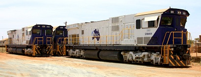

Hello all This is my first post. I have started designing a 6W 'Australianised' Alco C636. The plan is to use power functions. A picture of my progress in SR3D Builder including the position of the IR Receiver is here and the real ones for comparison (Courtesy of Pilbara Railways.) Now my question is in regard to the pivoting of the bogies (trucks). I am after an experienced opinion here. Should I attach the front handrail to the bogie and have it all pivot or should I have the handrail fixed to the cab and have the lower half of the plough and knuckle move separately? What would look best when the MOC traverses corners? Is it worth the extra effort to have the handrail maintain alignment with the cab? Thanks Glenn
