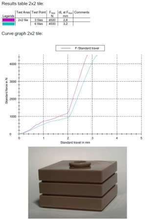

  2. I did a test with 2x2 plate modified and after the initial deformation of the top stud, nothing happened to the actual plate. So the plate configuration will tolerate above 5000N with is the limit of our current load cell. Regarding the UV-testing I actually have access to one . The problem is that its running a outdoor test at the moment but sometime next year we will run a indoor simulation and then I can do a complete test of different colors and materials if there is any demand for it.

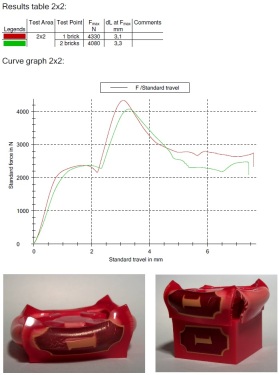

  3. Here are the results from test 2. I think that test point 3 in the first graph is a non-LEGO brand brick. One interesting reflection is that its not that easy to calculate the maximum height of the tower. Although the maximum force the brick can withstand is ~4400N it has deformed ~2,2mm at that time. That's almost 20% of the bricks height.For an accurate height you have to look at each individual brick and determine how much weight its subjected to and subtract the corresponding deformation,

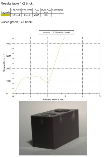

  4. I did a similar test today at work. I have attached data and pictures. As you can see the studs are pressed in to the brick and then i collapses. Tomorrow I´ll retest with a tile on top and a plate on the bottom. (I had to make the images really small due to the 100kb attachment limit)
