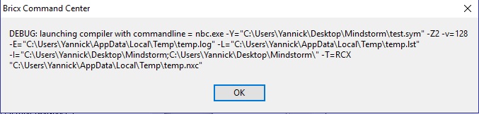

  4. Hi again! Here is the message from the debugger Thank you very much!
  5. I didn't even know there were multiple possible programming languages using BricxCC so my apologies. For me, using bricxCC meant I was writing code in NQC. My bad, sorry. First of all, thanks for your patience. I ensure you I am trying to be clear, English not being my maternal language and computers/programming, no more than a hobby. So, please, don't take my ignorance as a personal attack or a lack of willing to solve my problem. The answer to your questions is "correct" for all of them. - I am running Windows 10 - I know where to find the program path - I can download the firmware without any error The instructions you kindly wrote should be easy to follow. I'll try these in a couple of hours and paste the results here. EDIT 1: - The command "nqc -TRCX2 -watch now" returmed "Problem talking to IR device" - The command "nqc -TRCX2 -SCOM2 -v -watch now" returned "Could not open serial port or USB device" - I will try to paste the image I took from the debugger after compiling the program I wrote - Are you really the mastermind behind BricxCC? Just so you don't have to ask the question, COM2 is the one I use when I successfully download firmwares to the RCX. As for now, be sure I appreciate very much what you are all doing for me. Have a nice day!
