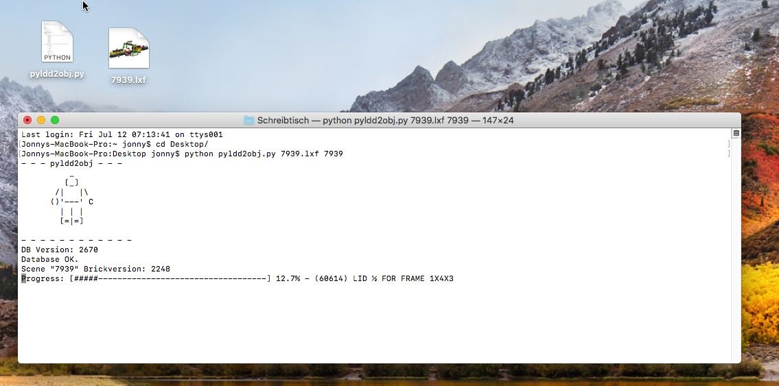

  1. 1. install LDD 2. copy the script and the lxf to a folder 3. open console 4. navigate to the folder 5. run "python pyldd2obj.py nameofyour.lxf nameoutputobj" 6. now you have nameoutputobj.obj at the folder thats all
