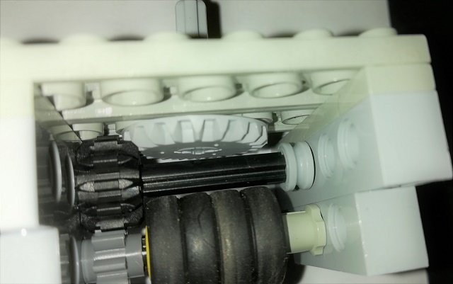

  13. It could be that i try to turn it by hand on a short axle. But i think all works out when i place the motor on the top. the axles runs free. Is it only tiles under the motor ? The Motor is locked in place by the "couplings" ?
  14. I thought of that but did not see anything that caused the problem. But have now removed one tire and put the black gear on a tan pin w/axle. What i noted that everything was run fine until i put on the axle with the tires, I think it is the friction between axle with tire and the black gear. What length of the axle on the motor ? 2L
  15. Here is a closeup picture of the gears . having 2 more wheels is due to my design. I may reveal the the design later.
