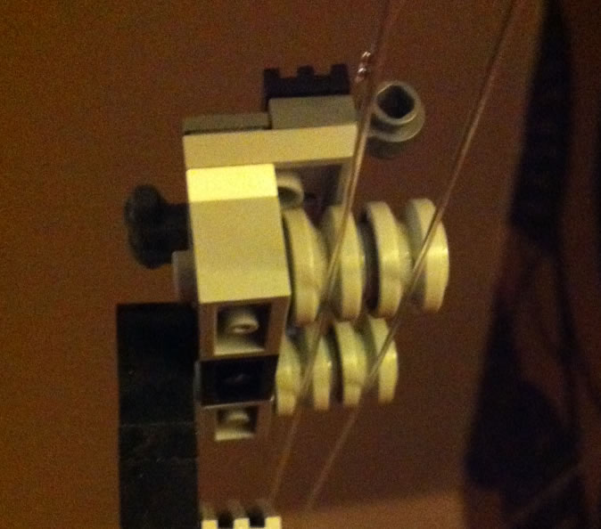

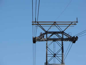

  4. Dear all! I have a construction issue that someone might be able to help me with ... In the first picture below, one of the two cabins on my Lego aerial tramway. They travel along two wires (nylon rope 0.7 mm) on wheels (currently model 42610). These wires need to be supported by a tower along the way, and the challenge is to construct "saddles" for each side of the tower that can support cables while allowing for the cabins to slide over - without falling off. I have temporarily solved this with a wooden structure, but it is supposed to be all Lego in the end, right:) Below a picture of how these saddles usually look irl. Perhaps I can build something similar, but I have no clue what parts to use. Perhaps there is some sort of thin tube in the range that I can attach to the saddle, and let the nylon cords run through it and the cabin slide on top? Tricky ...All ideas are more than welcome, also entirely different solutions all the way:) Best! //E
