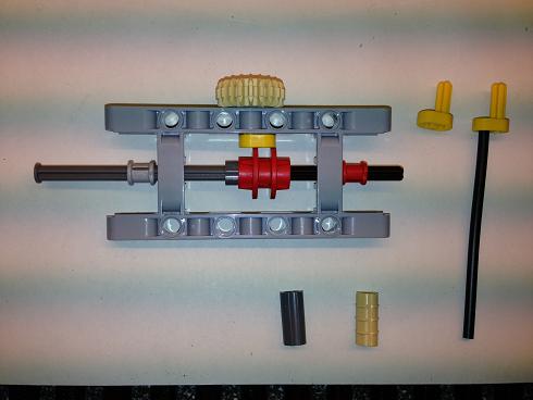

  5. Yep, that's it ;) As I wrote in the youtube movie, the actual pin used could've been a Lego Rigid hose (3mm), cut to a length of 7-8mm (a black uncut shown in picture below). However, I like my Lego just too much, so I couldn't bring myself to cut a piece. So insted, I used a piece of wood (barbeque stick = large tooth pick... kind of) which by the way is NOT shown in the picture, but you see it well enough in the youtube clip. The good part with the crankshaft is: 1.) It fits perfect without causing NO friction against the clutch (see picture below). 2.) It makes that perfect half studlength move that is required for the "clutch". Also, worth to note is that I used the smooth axle-connector in the center, since I didn't want friction/"clicks" in the gear changing, my own gear selector has it's own clicks and works better with less friction. ***edit - should of course be NO friction*** Thx m8 ;)
