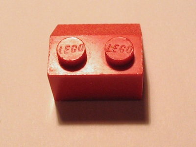

LEGO Historian Posted January 10, 2014 That seems likely - but are rotated logos common on pre-1962 European bricks? I haven't seen enough of them to know. Yes and no..... I am only aware of Samsonite "retooling" their molds. I am not aware of TLG doing so. They just basically retired molds. However, TLG has this propensity of surprising us with what they've done in the past. Finding strange bricks is not unusual. When TLG switched from slotted bricks to hollow bottom bricks in 1956 (with the coming online of German to LEGO sales)... there were some hybrid bricks produced... that had the smooth slotted type underside (with the LEGO logo printed in large letters), and with the LEGO logo on the stud as well (prior to 1956 the logos were underneath... starting in 1955-56 they moved to the studs). So some of these "transition" pieces had logos on both top/bottom of the brick. Another quirky feature that they might have is the logo rotated 45 degrees on top... so that ALL the logos on the brick might be facing one of the long sides of the brick, which goes against the normal way they've done it (facing a short side). Share this post Link to post Share on other sites
62Bricks Posted January 11, 2014 Modern slopes have the logo facing the long side with the L closest to the slope surface. However I have a few old slopes with the logo facing a different way - hollow 2x1 45-degree slopes, red, with the "modern" logo facing the short, square end. I also have a 2x2 45-degree slope with the old style logo facing the square end. In this case, the logos are rotated slightly off center. It's from a North American set, but I'm not sure which. This rotation is what makes me think the logo part of the mold was interchangeable and could possibly become misaligned during production. Or perhaps that part was drilled out and replaced with a round plug that had the logo imprint, and the plug could become misaligned? I'm sure all we can do is speculate at this point, but the quality control that LEGO has exercised over the product since the first days make little imperfections and variations like these fascinating. Share this post Link to post Share on other sites
