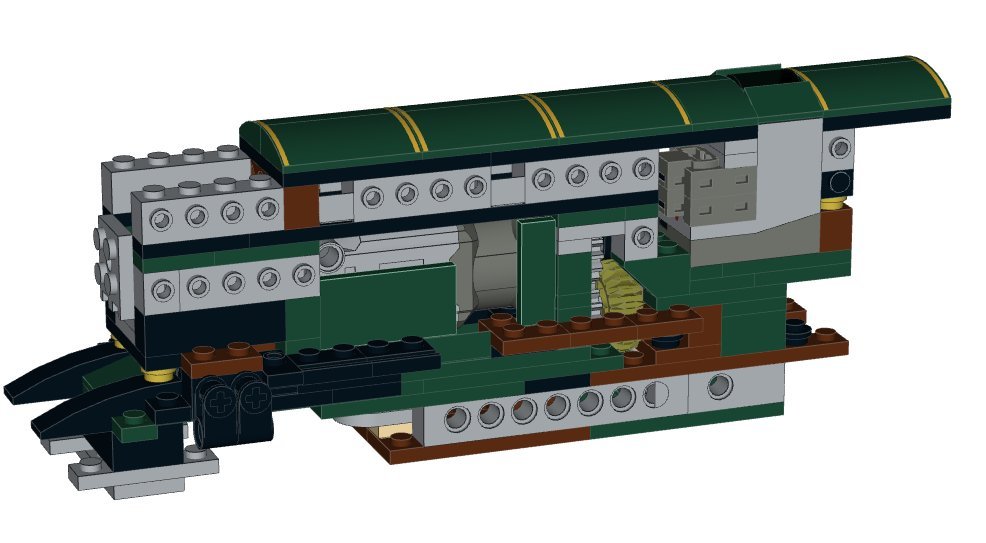

Hi, I just managed my Emerald Night with a 88003 (L-Motor) inside the boiler. I will post it in some days when I have some pictures. Here is just a picture to see the modification with the motor and the receiver.10194_L-Motor.jpg.76c08b68bb40e85df40917fc07a05a20.jpg
Edited by Oliver77
