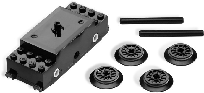

To 1) It is true what you write, sorry, my mistake is correct, it is this:
Power Functions Train Engine Item: 88 002 Price € 13.99.
88002-1.jpg?1
Here you can see why this engine is better
http://www.philohome.com/motors/motorcomp.htm
To 2) it is not important. Which part you take.
