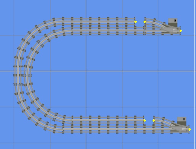

If you want to put a turn-in a turn you always end up with a half-length (8 stud) offset so you cannot connect the two with a switch point while keeping the parallel turn idea. Has anyone tried modifying a single straight (cutting / sawing / etc) into halves to fill this gap?
- Sok.
Like this:

Why do you want to use two identical point sets? With opposing (left/right) this works... but the 'vertical' tracks (on your image) would be further apart by 8 studs...
Cutting the plastic track is easy - cutting and soldering the tabs for the 12V rails would be harder

Points are just for illustration ;) You're still left with 8 offset even if you do it the other way around.
I cut up one piece of track just now, will have to see how it works.
