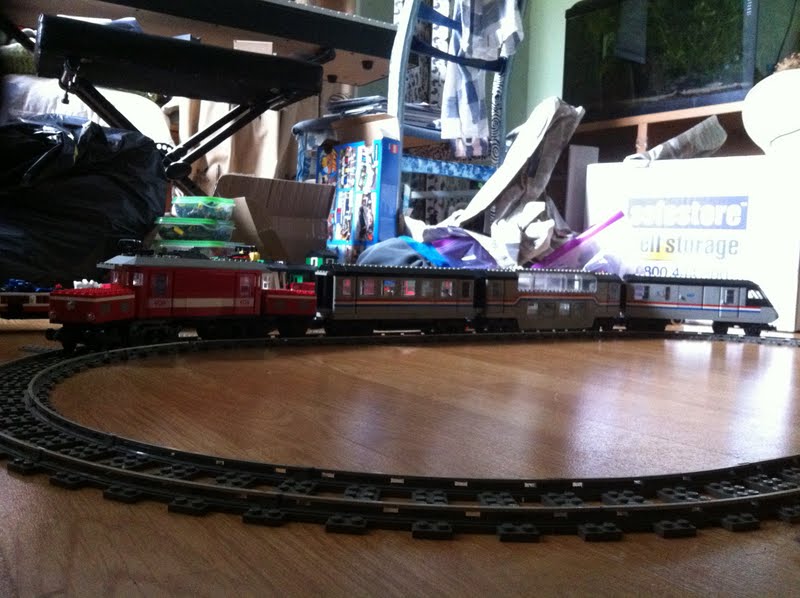

Pulling my Metroliner coaches and Club Car. Easily managed this load. I had it going round the track so fast that it started sliding across the floor, as it's a wooden floor.

I faced the same problem with my mod for a more realistic br1020 locomotive (slightly longer nose, lights etc). Like you I found the thick roof a pain but it seems to work well enough. Congrats, and looking forward to some nice metro liners to work with it
