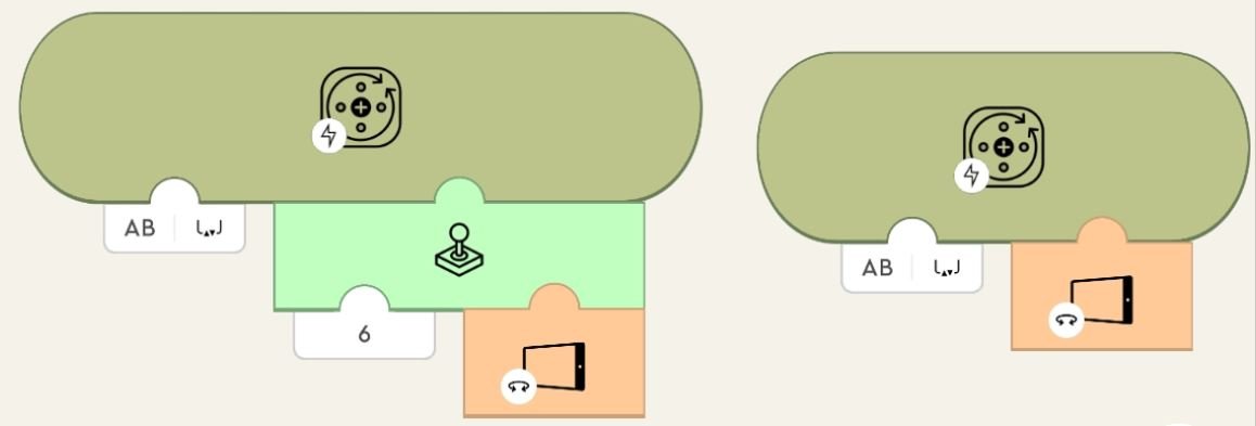

11 minutes ago, Lok24 said:
If you tilt the smart device?
Please send a pic ....
(here it works fine...)
Sure, here it is. None of these 2 options do anything.
Share this post
Link to post
Share on other sites
the right one is correct, but indeed: does not work with "AB". With "A" it does. A second block with "B"only  added: both motors running. A bug?!
Edited by Lok24
Share this post
Link to post
Thanks for pointing me in the right direction. Also, you may be bugged, but I'm not and AB is working for me now. And do you want to know why it didn't work for me before? Because I was in the code menu, not the controller menu :D Facepalm moment right there.
Sure, as in the right example there is no controller any more.
Concerning "AB": seems that it is only working with two motors with the same ID.
