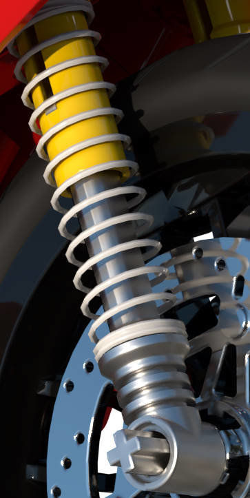

I want the springs (u9409-f1.dat) of the 2909c03 shock absorbers to have customizable colour in Stud.io, because they are being rendered white.
What I already tried: Editing the .dat file directly and replacing the "16"/"24" color codes by "383" (colour code for "Chromed Silver" which would be my color of choice) and loading the adjusted part into PartDesigner (where the colour of the part in the UI changed) - but after exporting this to Stud.io it stays white and non-adjustable.

3 hours ago, SylvainLS said:
But, again, that won’t solve your problem! In Studio, the spring will still show white but it will render as chromed.
Unluckily not with the photorealistic renderer (at least not for me) - I added two screenshots of the renders with the regular shocks and the manually put together one with my modified spring-file

1 hour ago, aFrInaTi0n said:
One last thing: You also have the spring rendered in white with the original file, so may there be an error in that part in the LDraw repository?
The part on the left is with 383.  The part on the right is the stock one, with 494, and it indeed renders White.  My previous tests were too quick and there must have been a play of light that made me think is was metallic.  That’s why I added coloured parts around in this render :grin:
494 is not “known” as a colour by Studio (yet), so it doesn’t work.
