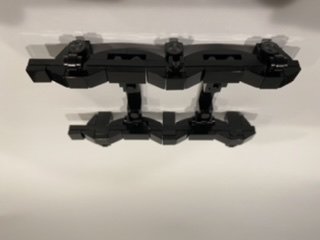

Here is the completed assembly.
I have skipped the steps with tubing. Top of assembly, left to right is:
slope 1x1, tile 1x1, slope 1x1, tile 1x2
Repeat above
slope 1x1, tile 1x1, slope 1x1, tile 1x1
Update: Sorry for upside down photo, cannot seem to flip it.
Humberto
Edited by Jedi Bert
Update on photo.

8 hours ago, cbqmp27 said:
Daedalus304,
I currently am stuck at steps 225-229, too many black parts on black parts with no clear way to indicate where they go.  Thanks for whatever help you can provide.
Hey cbqmp27,
I took these two pictures of the completed truck frame for you, and changed two of the minifig neck brackets from step 225 to Light Bluish Gray to help make it more apparent where they're going.

Indeed this makes sense, and I appreciate the time and effort it took you to reply to my inquiry.  Thank you very much.  I'll update this post sometime tomorrow when I've had a chance to work on it.   Again, thanks

Daedalus304, those pictures you posted gave me enough detail so that I could complete the truck assembly, I do appreciate the help.  By chance, were you the designer of said model?  Anyhow, many thanks for the tips, they were appreciated.
Jedi Bert, your tips were helpful as well, the biggest stumbling block for me was where the 1x1 plate with clip light and the 1x1 neck bracket was used, the diagram in the instruction book was flawed in that regard.
