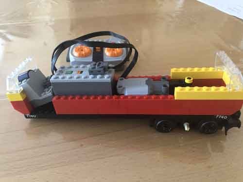

brick-builds Posted January 24, 2021 Posted January 24, 2021 In my new project I will integrate a power functions motor in the 7740. Here is the first photo, a video comes soon. Quote
Paperinik77pk Posted February 1, 2021 Posted February 1, 2021 (edited) On 5/24/2020 at 4:42 PM, zephyr1934 said: The 7740 set is considered a classic. So I would suggest you do not modify the parts. The 6x28 train base that came with it should have 1x2 holes. I'm pretty sure you SHOULD be able to squeeze the PF connector from the motor up through the bottom of one of these holes. It will be tight, but it should fit. It can be done - with some patience and a bit of wd40/soap/lubricant of some kind. I also modified a 7740 to PF in the past (using original train motor and lights) and it worked fine! My 2 cents on the very nice project: Central third wheel on motorized bogie: On the PF train motor and Technic-based bogies it will work as a fulcrum between the two powered axles, reducing traction. It is quite difficult to have a sort of "suspension" for central wheel like in the old 7865 12v motor, so I tried to remove traction bands and it worked quite fine. Position of battery box : It's always a mess - it should be over the motor to increase traction. Problem occurs when using a PF motor inside the cabin, since it limits the possibility to transmit power to the bogie (the risk is not to respect the internal height). Due to this I came back to the original PF Train motor instead of a more technically interesting solution like an internal motor. A possible solution could be using a 7.4LiPo battery used for drones. Smaller, rechargeable, but it depends on personal taste. It could give the interesting possibility to have two traction bogies, placing motor in the middle and using two cardanic axles (very similar to H0 model trains). Good work, I'm curious to see how it turns out!!! Ciao! Davide p.s. I found some photos of the second conversion (motor PF and real 12v wheels - here all with rubber bands) - you can find them here: https://photos.google.com/album/AF1QipOtQB9uuRU41-NBkJ-5iCYAiahPi0McZsrwp_G0 Edited February 1, 2021 by Paperinik77pk Link to 7740 PF Mod Quote
