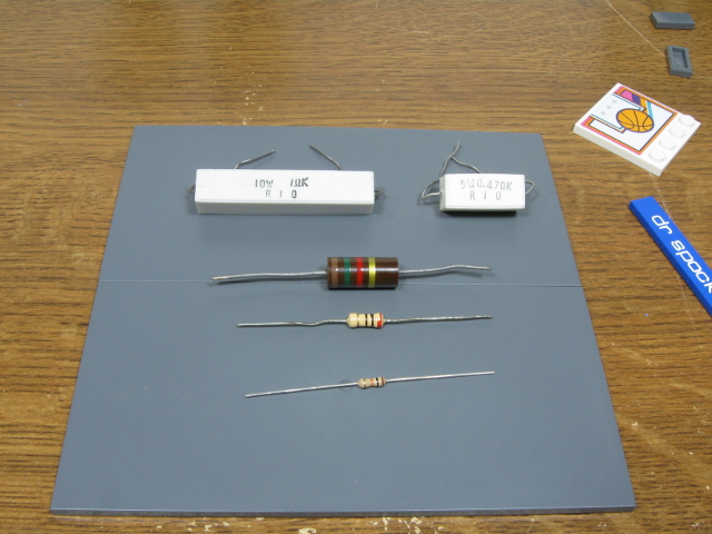

Regarding the resistance: That are the 22 Ohms causing the voltage drop. I'd try something around 3.3 Ohms initially (a value of the "E12" Series). The thing though is the wattage, the resistor needs to dissipate as heat. The resistor you used seems to be of the 1/4 W series. I'd go for something like these: https://cdn-reichelt.de/documents/datenblatt/B400/5WAXIAL_9WAXIAL_11WAXIAL_17WAXIAL%23YAG.pdf The can dissipate 5W easily.
If that does not work (still too much voltage across the XL even at medium load), I'd increase the value to 10 Ohms or so.
Thing is: Just one part, clocking in at about €0.50 ...
But there must be somebody around here who for sure knows much better than we two 7/8 blinds (electronically-wise:laugh_hard:).

I do trial by fire too.  Larger wattage resistor is your friend like dynamic brakes on a diesel electric locomotive.
I guess size does matter.  :pir_laugh2:
