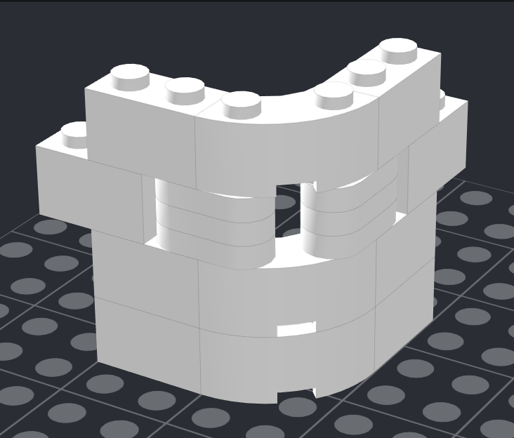

I want to build a simple cube, but with rounded corners and I'm wondering how I'd best do that. I still know the 2x2 rounded 1/4 corners from my childhood and was wondering how I'd secure those if I stack like 15 of them. I haven't found a legit approach for that and my own one does not look very good:
I would suggest to add a few 3x3 plates with rounded corner (part number 30357) at various points in the column. This part matches the curve of the 2x2 round corner bricks, but allows connections to the side walls.  Or, if there is enough space, you could use part 18980 1/2 circle plate 2x6.
OK, the 3x3 plate sounds good... Thank you!
