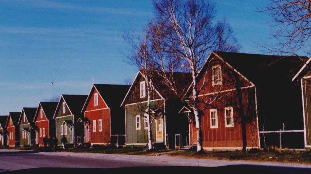

Hey all,
My current MOC, once complete, needs to be mirrored for a different version.The thought of doing it manually is... Well, it's not good. :-) Is there a "Mirror" option?? It could be for the whole MOC, or just a selection.
As well with the mirror, there also need to be a colour change. All the red bricks need to be green, and the green bricks need to be red. Obviously I'll need to do an intermediate colour change, but... Is there an option to select all bricks of one colour and change them to another colour?? Again, whole MOC, or just those selected??
Thanks in advance, all. :-)
This is what I am working on.

As far as I am aware, there is no mirror function in LDD.
For your particular need, though, it should be simple, since it looks like the door just switches sides while the rest of the house is identical.
...unless there are interior details or more things that switch sides that are not visible in the shared picture.

The mirroring is a little more complicated than that. The walls have an interior and exterior sides, and the sides are different. I'll work it out. But that colour change I guess is the bigger issue. And excuse me for being a bit dense at the moment, but, I tried what you described, and it doesn't work for me. So, obviously, I am missing something. :oh3: I'm pretty sure I did that before. But right now, I'm as dense can be. Sorry.

I figured there must be more to the mirroring issue than just the door if you asked for help on that, though it is not obvious from the picture.

If ONLY it was as simple as your example. :sweet:

What I have got done so far (8,225 pieces) - This is one of several phases the houses went through - 1919.
